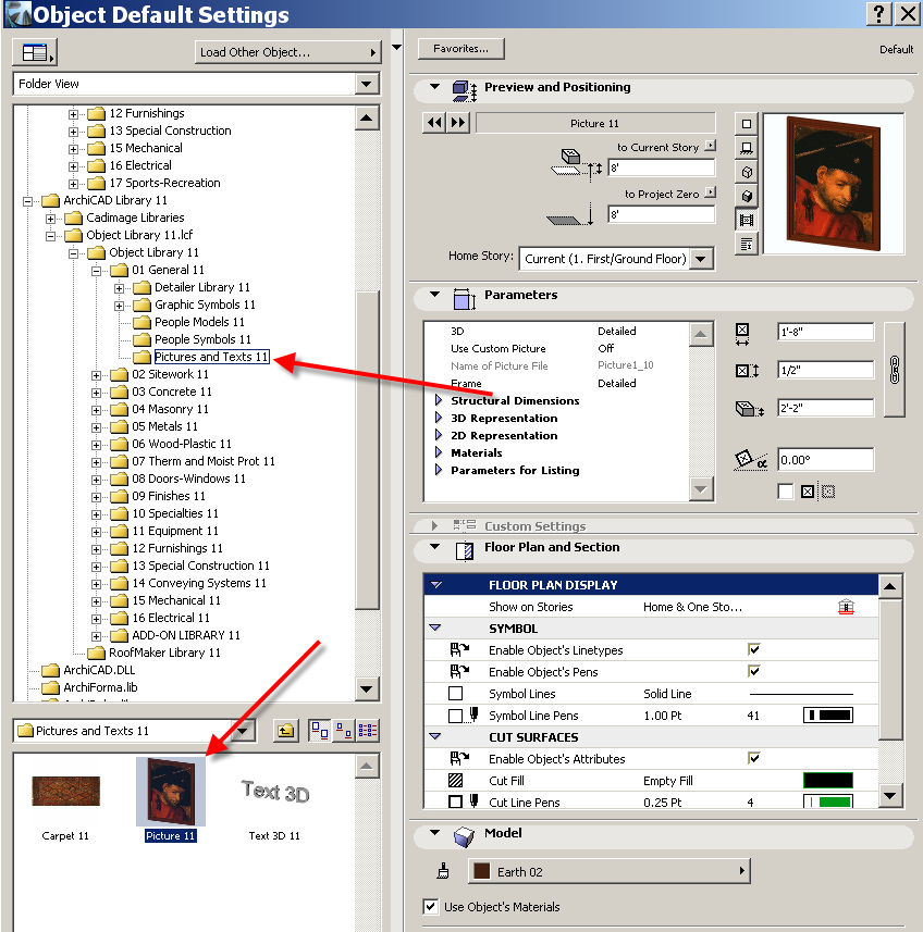

I am trying to insert images to be seen on the model and elevations as advertisements/billboards on a building. Could someone please tell me how to do this? Many thanks.

Try using the "picture object" in the Object Library under General>Pictures and Texts.

Not to sound like a complete dunce... It's just that I can't find it. ArchiCAD 11 BTW (if that saves me!).
I've tried adding images to the library, but they refuse to show.

Well, here's the best I can do. Your library might be different. But this is essentially a "billboard" onto which you can place an image, and then move that billboard wherever you want.
