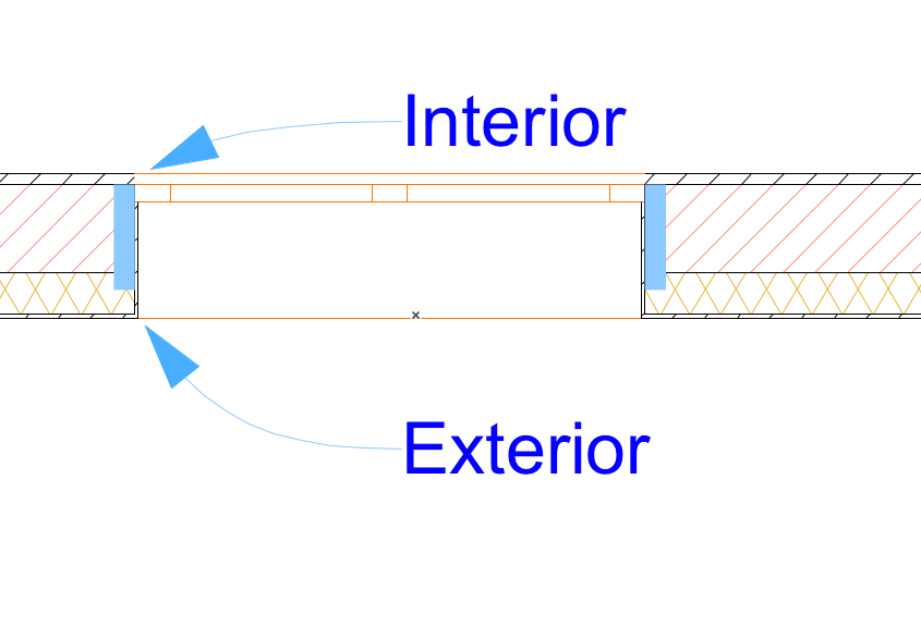

Hi, due to energy regulations I need o put the window in a prefabricated insulation frame (light blue) as depicted in the attachment, but can't find a way to do it with the ARCHICAD 21 window object. Any suggestion?

Try the "Wall Closure" settings in the window object, there is an insulated closer option unless it's just for the UK.
