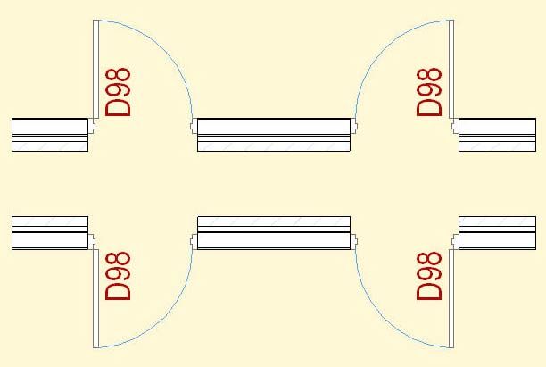

My question is: is there a way to have the Marker recognize the door opening direction/orientation so that it can automatically be placed (i.e. I do not want users to have to drag hotspots around for each individual opening). I've noticed the WIDO_ global variables, but I'm not sure how to implement them, since the Marker is associated to the door, but not a part of the Door object.

Yes it is possible, but not trivial. There are several interacting rotations/relations to account for, and some conditions that require custom doors (or custom adaptations to standard doors) to be fully automatic. I am actually working on this for some of my clients right now.

Ah, yes -- that's what I suspected -- thankfully, I haven't spent too much time straining my eyes over it -- let me know if you are successful -- LJY.
