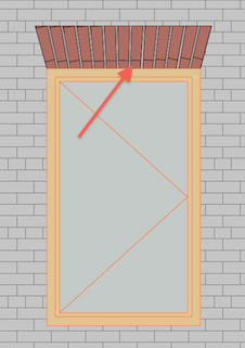

  • Section/Elevation view of masonry arch in doors and windows contains extra lines when textured material is used and vectorial hatching is switched on.
  • wp-content_uploads_archicadwiki_bugs-masonryarchprobleminopenings--windowelevation.png

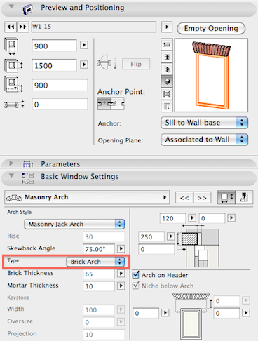

  • The Masonry Jack Arch is set to Brick Arch.
wp-content_uploads_archicadwiki_bugs-masonryarchprobleminopenings--brickmasonryarch.png

  • Solution 1: Pick a material for the bricks which doesn't show interstice in the texture.
  • Solution 2: Turn off 3D vectorial hatching in the section/elevation setting in case you want to use this material while modeling the bricks.

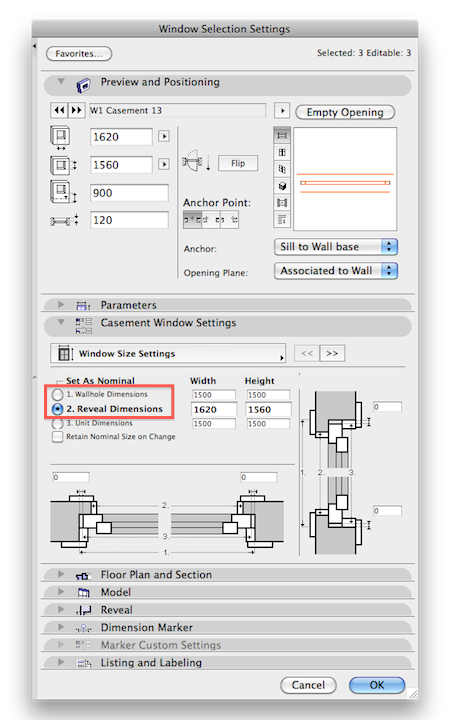

  • If there are several windows placed on the floorplan with different width, with Reveal chosen. Under Basic Window Settings tab Window Size Setting has Wallhole Dimensions as Set as Nominal. And we select the windows and change Set as Nominal to Reveal Dimensions then the width of the selected windows will change to the same. (To the first selected one.)
wp-content_uploads_archicadwiki_bugs-nominalsizesettingchangeswindowwidth--before.png
Cause
  • This happens because under multiple selection the parameters changed in the settings dialogue are applied to all selected elements.( Parameters changed by the user and parameters received from the script.)

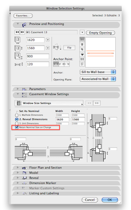

  • If we check in the "Retain Nominal Size on Change" option, then the new nominal size will usethe old nominal size. This way the width parameters won't be unified for all windows.

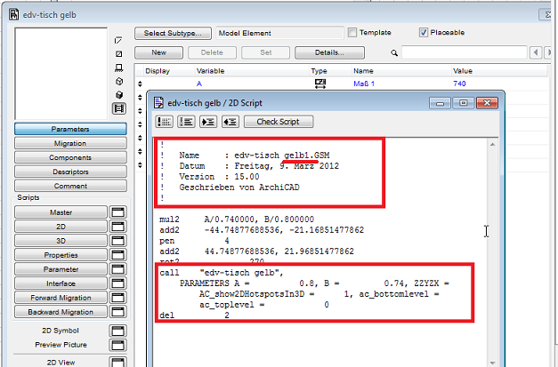

A library part used in the project was renamed using the Finder or File Explorer to the same name of a macro call used by it. This made the library part call itself ad infinitum (recursive). In the below example a table was renamed from the name ARCHICAD gave it "edv-tisch gelb1.gsm" to the name "edv-tisch gelb.gsm". The renaming lost its user several hours of work.
