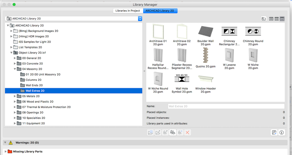

In "Project A" I am using a library part called "W Niche 20". It is under "Object Library 20/04 Masonry 20/Wall Extras 20". There are about 14 items available in the particular folder.
Now when I open my other project "Project B" and I go to find this same "W Niche 20" object via the Object Tool it is not there in that folder. In fact in that same that folder there are only about 3 items showing up. However when I go to look for it via the Library Manager I can see it in the folder as well as the other objects that were showing up in "Project A" in that same folder.
Any idea why it is showing up my Library Manager but is not available for me to select via Object Tool? Would love to know how to solve this! Thank you!

The "W Niche 20" is a Window, not an Object. It can only be used with the Window Tool.

Wow I feel silly now...somehow I got lost on the library path and thought I was seeing that as an object someplace else. Anyway just found it in the windows with no problem - still new! THANK YOU!!!
