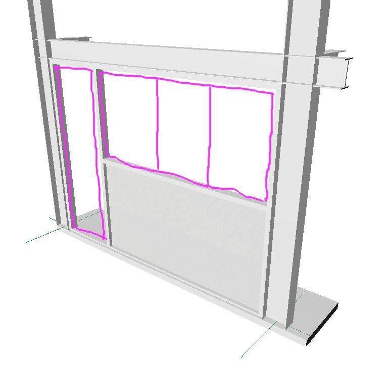

Any idea how I can make 2 panels in my curtain wall unit with louvers.
Should I be using the curtain wall here in the first place?

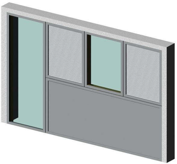

Try using the Modular Joinery object - all ArchiCAD users on subscription in the UK should all have received it, so you probably have it to hand.
You can make any arrangement of windows, doors, panels, louvres, etc. A quick example along the lines of what you requested is attached.
