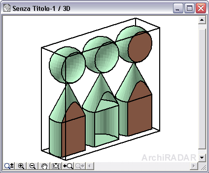

MODEL SOLID/SURFACE error
rocorona
MATERIAL 1
MODEL WIRE
	BLOCK 1.00, 3.40, 3.00
ROTy 90
ADDz 0.75
::CUTPLANE
DEL 2
MATERIAL 41
MODEL SOLID
	ADD 0.50, 0.50, 0.00
	CYLIND 1.00, 0.50
	ADDz 1.00
	CONE 1.00, 0.50, 0.00, 90, 90
	ADDz 1.50
	SPHERE  0.50
	DEL 3
MODEL SURFACE
ADDy 1.20
	CYLIND 1.00, 0.50
	ADDz 1.00
	ADDz 1.50
	SPHERE  0.50
	DEL 3
DEL 1
MODEL SOLID
ADDy 2.40
	CYLIND 1.00, 0.50
	ADDz 1.00
	ADDz 1.50
	SPHERE  0.50
	DEL 3
DEL 1
::CUTEND
this works correctly in previous versions of ArchiCAD, but
in AC 8.1 (as you can see in the bottom image) one of the shapes defined as SOLID appears hollow.
I haven't done a full test, but it appears that the MODEL SURFACE affect the bodies after the directive, PLUS ONE before it... !
Eg. putting another MODEL SURFACE between the last DEL 1 and the CUTEND, the last sphere becames empty.
This does not happen if the MODEL SURFACE is AFTER the CUTEND.
Is this a known bug? Or I'm doing something wrong?
