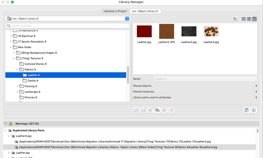

I was able to find the xxx-Object Library 9 file and I just happened to drag it into the "Libraries in Project" tab.
I migrated it and it removed all of the missing files! You have helped me a great deal - many thanks!
I only now have Warning of 427 (0) Duplicated library files.
I can see Library 9 duplicated files in the Library Manager, but with no option to delete.
Any suggestions

I think because you have loaded the original version 9 library as well as the later migration libraries, you are getting these duplicates.
If there is a version 9 migration library to use instead then maybe you would not have these duplicates.
The migration libraries only contain what is needed and not all objects and image files.
I would not load the 9 library and I would replace any missing objects with a new object.
The old objects may not work so well anyway.
Best to get rid of them if you can.

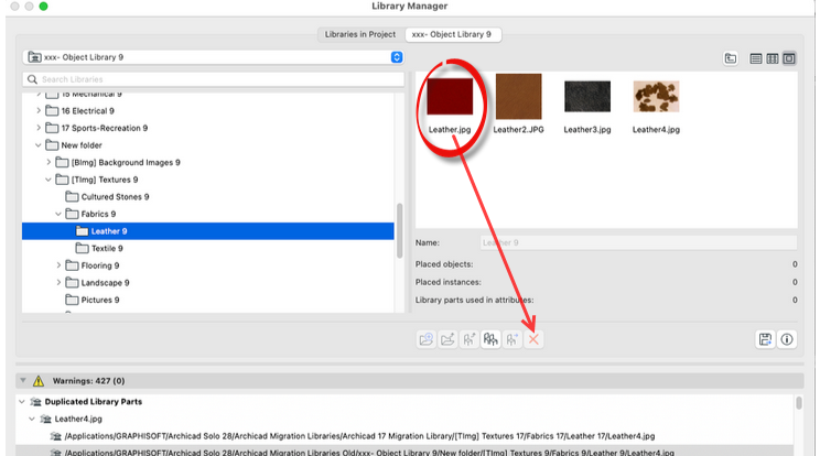

But if you select the duplicated file on the right hand side of the Library Manager, you should be able to delete it.
It might take a while to work you way through deleting 427 files though.
Be careful not to delete anything that is not in the duplicated list.
Thank you again Barry!  My only issue is that the delete "X" is not an option when I highlight the file.
