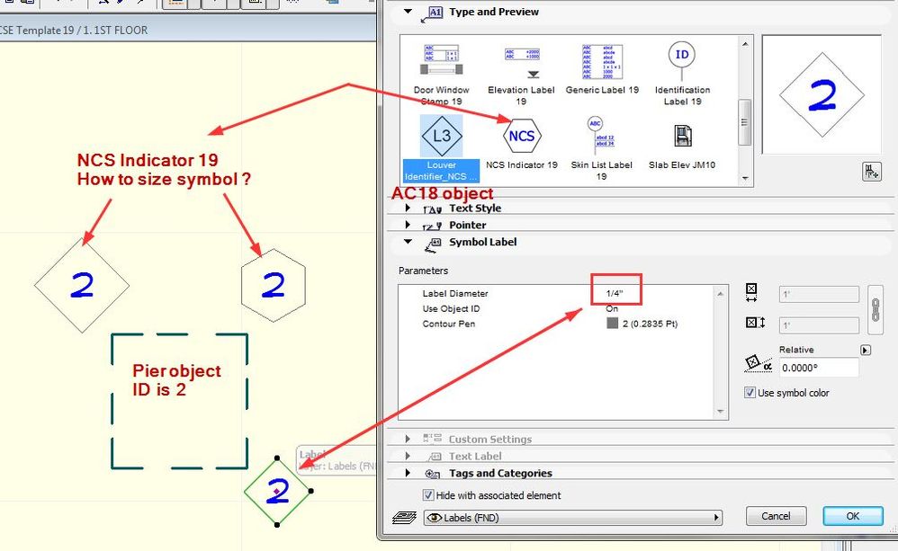

In the previous AC18 Louver text object the symbol size could be adjusted. I do not see this option with the NCS Indicator 19 object.

Jay:
It looks like this is "by design", in the 2D Script the sizes are hard coded with comments like "! NCS standard 1/4" (6.35) 6 by design". You can try the Identification Label 19 which has shape and size options (Custom Settings > Label Geometry), but only if the pointer is not activated.

Thank you David. You are always such a great help. I will look into the Identification Label 19.
