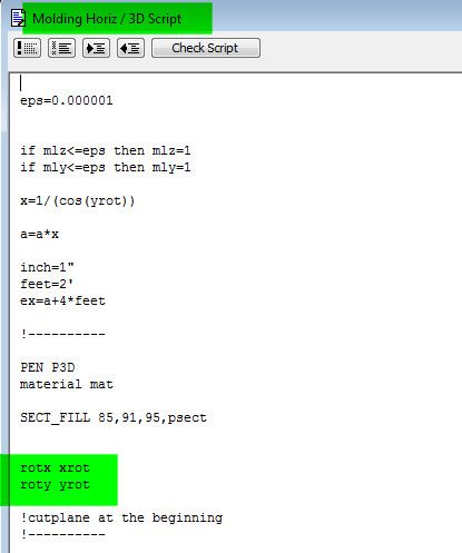

Need GDL script for rotate
Steve Jepson
These objects are great. I like how smooth the curves can be displayed.
I would like to use these moldings on the slope sometimes.
Would one of you GDL Guru's like to share a script that could be added to these objects so they can be used on a slope ?

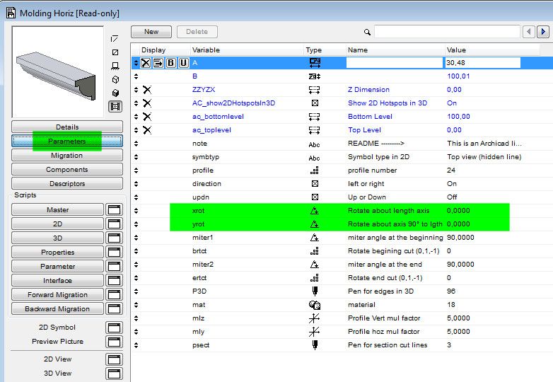

It may not be so hard to add Rotations:
1. Parameters Script:
2. 3D Script:
Steve Jepson
Yes That's the one. Thanks.

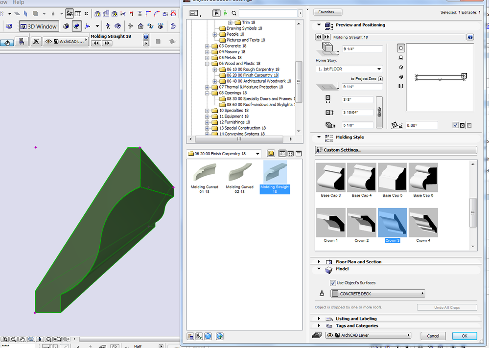

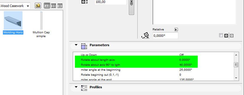

3. Setting desired Rotations:
