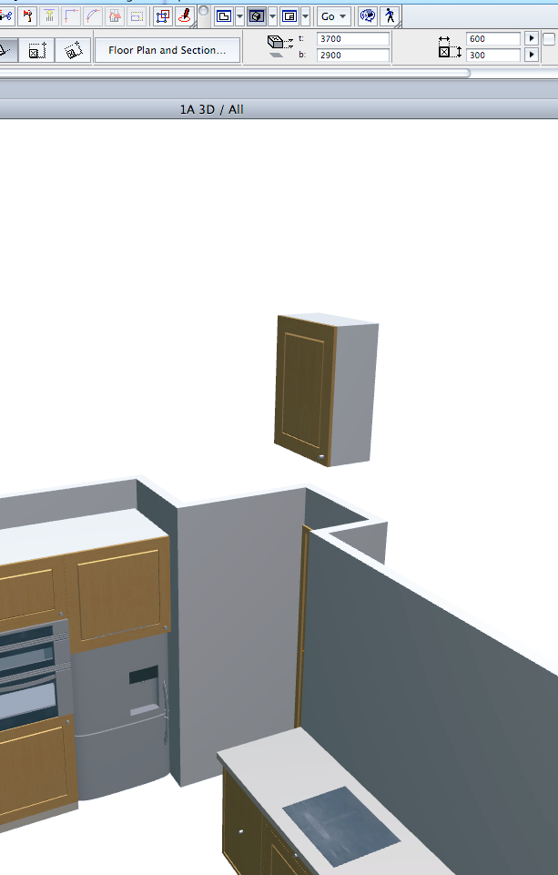

When I select a kitchen cabinet object - I want to place it on the wall from at 1300, height 800mm high (finishing at 2200mm from floor).
However, when I do this and view it in 3D it has been positioned sky high instead of the correct place.
Here are some screen shots (just to help my explanation make more sense):
First one is of the objects tool box and (in the next post) the second one is what happens after I press OK.
Why does it do this - I'm guessing I made an error somewhere (I do notice the numbers have changed after I press OK but that's not my doing, that's CAD doing it! Please help? I'm still learning how to use this software.

Second picture:

kiwistudent:
Under Parameters, the first parameter is "Placement Height". You can use this to set the height of the cabinet above the story, or set it to 0 and use the "to Home Story" input under Preview and Positioning.
