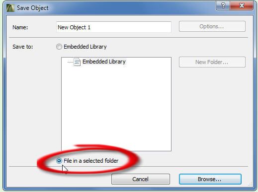

I know you can save your own custom objects by File -> Libraries -> Save selection....
BUT it only saves the object in this project if i open a new project (new archicad) then there is just the embedded library and no objects in it what i have made. Do i have to save them some other place to be able to use objects what i have made in other projects to?

When saving your object you will have the option to save in a selected folder.
If you have already saved in the embedded library you can open the Library Manager and export the selected objects into a folder on your system.

In addition to Barry's advice, embedded library parts can be exported: open the Library Manager, open the Embedded Library folder, select the part(s) to export, then click the Export embedded subtree into local folder button (looks like a floppy disk).
