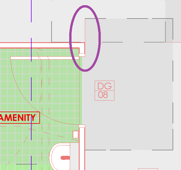

I was wondering if there was a way i can change the pen settings to a certain part of the Minimal Space for Doors? Specifically the lines along the wall side of the minimal space fill. I've attached a screenshot of my query. the line in question is the red line encircled by the dark purple oval. i was hoping to have these lines match the pen of the perimeter fill pens for the minimal space fills (currently shown as pen 95/Gray).

Gerard:
It looks like ArchiCAD is using the Cut Line Pen of the host Wall (normally this line would align with the face of wall) for this line. I do not see a way to alter this without getting into the scripts of the door, which are very complex. One workaround is to cover the line with a white line, then cover that line with a line that matches the Minimal Space line.
