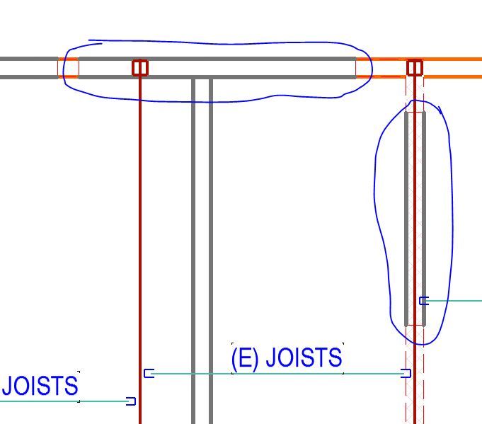

I turned my floor plan into an RCP by changing the door & window options (in Model View Options) to "show opening only w/ contours"...but as a result, my door & window openings are shown with HEAVY line weight (attached). Could someone please let me know where I can change this? Thanks so much!

That pen is from the Wall > Floor Plan and Section > Outlines > Uncut Line Pen.

I think you'll find it is set in the door or window's settings, in the Floor Plan and Section tab, Symbol Outline pen.
Thanks a lot, David! I only looked in the door and window settings but not ones for walls.

So glad I found this thread! I always pull my hair out trying to remember where to find this setting.... seems so illogical that it would be with the wall settings instead of the windows and doors.
