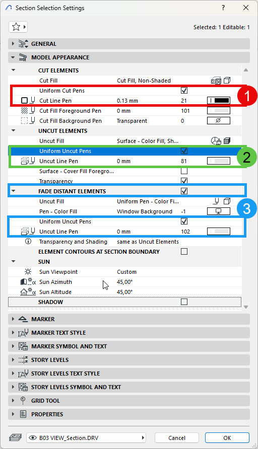

You can also check the Section or Elevation settings, where you can override the cut and non-cut elements appearance.
Thus you can assign a consistent cut contour line pen (1) with a thicker weight, and a fine line for everything else (2).
And if you feel especially tricky, you can even spice it up by turning on the depth separation and assign an extra visual layer on top this (3).
Just by playing around in the Section / Elevation tool settings.
Although, keep in mind that the Graphic Overrides and MVO settings will always overpower these.

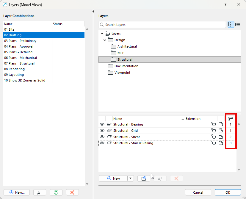

Now this might not be the source of your issue, but similar problems can be caused when the elements are on separate layers and the layers connection class is different.
If the connection class is different between two layers, the elements will not "intersect" with each other among the two layers.
If the layer connection class is set to "0", it will not even intersect among the elements on the same layer.
This can be powerful sometimes, since you can lighten up the computer's calculations load when generating a view, but frustrating as well, when random lines appear, where there should be none.

When you are using the layers, just keep in mind, that if you wish the elements to intersect, (and the computer to calculate with it,) that those layers are on the same connection class number.
Of course, the building material issue can still be relevant then, since the fills will only merge visually if the building materials are the same, and the stronger material will cut the weaker one (unless you do some extra wizardry with some solid elmement operations...).
Check the active layer combination assigned to your section view.
The saved layer combinations also store the layers connection class, not just the visibility and locked status.
