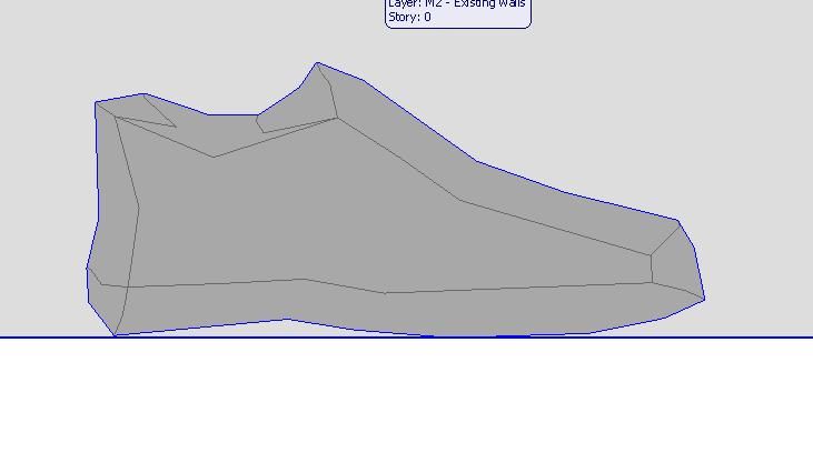

I have a problem that i don´t find a solution for.
The model is created from a 3ds, an works well.
But, I want to change the look of it in the section view. Just keep the outlines and remove all the other lines.
Maybe change the color of the outline to black.
How do I do this? In the 3D script?
See enclosed GSM and picture.
Thanks
Best regards/
Olle

HI OlleEK,
try to change the status code of the Edge from 2 to 1 in the section wiev.
Example:
origin:
EDGE 1, 2, 1, 168, 2 !#1
new:
EDGE 1, 2, 1, 168, 2-1*(GLOB_CONTEXT=4) !#1
Best Regards,
Hi Ila2
I can´t get your GSM to work.
But doesen´t your solution mean that all lines will disappear in section view?
Does anyone else have a solution?
