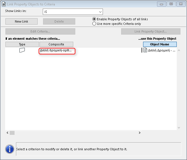

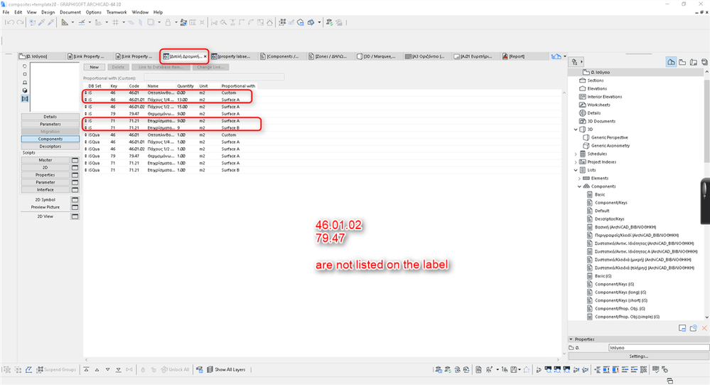

Hi I'm working on a label that shows the keycodes of the components of the associated properties.
I used the example in gdl guide on REQUEST ASSOCEL_PROPERTIES
I used the command in the 2D script not in parameter or master script
To make an example I used a composite wall and its associated property object.
The property object has many components that retrieve information from different databases.
The resulting label is alittle bit odd.
It retrieves the key codes from the property object from components of both of the databases that is use, but not all of them.
furthermore I would like to ask how I could limit my results to the key codes of the components of a certain database? I don't understand clearly how the matrix stores data and if I should use one or two dimensinal array and how to retrieve certain information.
Thanks

I finaly managed to get the code running. A kind of property label is ready.
It filters info from the retrieved array by category of info.
Generally filtering within the array can be made only by index.
I tried many combinations of string functions and expressions and nothing works you cannot make string comparisons or filter info by string contents.
for example
IF DATA = "KEYNOTEDB" THEN
TEXT2 0,J, DATA[i+2]
is not working
if I want to get the keycodes of the descriptors that come from keynotedb
I could filter iscomp for descriptors 0 or 1 then the database "keynotedb" and ask for KEYCODE but this seems not be possible
I also noticed that descriptor info is read first then it reads the components
they are stored linearly in the 1D array in a series of packets of requested values in the order that was requestd by the REQUEST command
