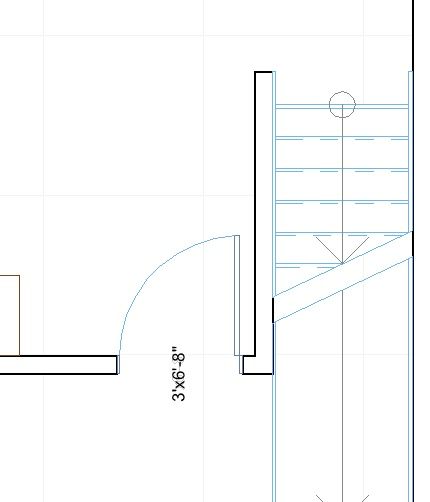

I would like to orient the door marker ( builder dimension ) along side the panel of the open door. The only option I have is to orient it across the door ( the direction that I want ) but not to slide it to the panel so it is out of the way of the "entry" .... is this possible ???
if you look at the image, the marker-text has to move up a bit and be moved to the open panel of the door.....

I don't think it's possible with the marker you are using (this particular marker does not have parameters for Marker Position and Offset as others do). Door Marker 11 does not allow you to place the WxH in a single line of text, and Door Marker NCS 11 does not show the door size (unless you insert it with a Custom value).
