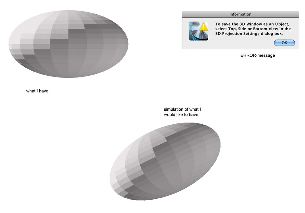

I was creating an eliptical-sphere with the roof-dome-tool (2 domes putted together to a sphere... saved as an object, later then just streched to en eliptical shape)
The problem I have now is following:
I cannot rotate the object in the Z-direction, just in X & Y.
But the thing is, that I would like to put there an angle of 25°. I can simulate this effect by customizing the Paralell projection view-settings in the 3D window, but then, If I want to save my object in that position, an error message appears.
see attachments for comprehension of my problem..
can someone tell me how to solve this problem? how to simply rotate my object??

Hi Hugo,
Perhaps I'm missing something... But why don't you use the "Elipsoid 12" object from the AC12 International Library?
HTH.
