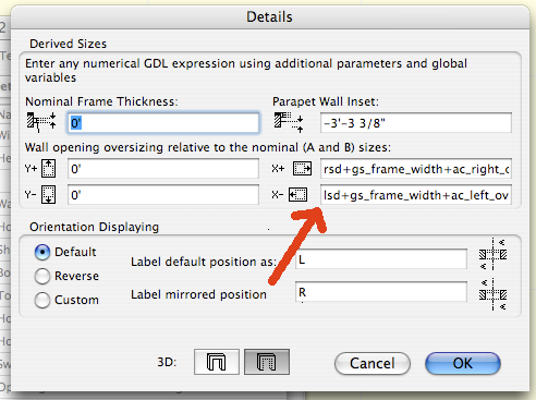

However, in 2D when I turn on the sidelights what is the best way to get a correct wall opening? Right now I am forcing a variable to the values needed to account for the sidelight width beyond the values of A and then using this variable in the details section ("Wall opening oversizing relative to the nominal (A and B) sizes"). While this does work it seems a bit ad hoc and very dirty.
IF sidelite='Left side' THEN VALUES "lsd" xsidelite_l+mullion VALUES "rsd" 0 ENDIF IF sidelite='Right side' THEN VALUES "lsd" 0 VALUES "rsd" xsidelite_r+mullion ENDIF IF sidelite='Both' THEN VALUES "lsd" xsidelite_l+mullion VALUES "rsd" xsidelite_r+mullion ENDIF
I have also tried using the WALLHOLE2 command, but it does not seem to work the way that I want (although I suspect that this is my lack of knowledge).
Does anyone have some guidance?

When I did my doors I used masking elements in the 2D symbol to cover irregularities in the 2D opening. WALLHOLE2 did not exist then. So this is from investigation rather than experience, but it looks like the advantage of WALLHOLE2 is that unlike standard POLY2s they can cut the wall rather than simply mask it. The disadvantage is that WALLHOLE2 polygons can't have a contour, so you need additional 2D line shapes. Like WALLHOLE in 3D, WALLHOLE2 replaces the default A-width opening.
The 'oversizing' is a separate issue from the graphical appearance of the 2D symbol. You still need to use the oversizing values in order to get the opening to show the sidelight width when the doors are 'off' in Model View Options.

Now that I am not quite as brain dead as I was when working on this before, I can get the WALLHOLE2 command to work as expect, my "Y" coordinates were flipped and so were outside of the wall.
This seems to be a much better way to handle the situation. Of course I, this method does not seem to work with a curved wall as the Wall hole remains straight. Or must we script for the curve as we would for trim and frames?

• In the old days you would just use POLY2_Bs to mask the cut part of the wall, yes.
• Curved walls need to be handled explicitly with curved symbol stuff. The key point is the global variable WIDO_ORIG_DIST (R_).
• Not sure what the goal is with your VALUES statements. It looks like you're trying to set the right and left distances depending on whether there's a sidelight. For that you should use PARAMETERS:
So, lsd and rsd have to be parameters in the parameter list. You should hide these to avoid distracting the user.
lsd=xsidelite_l+mullion
PARAMETERS lsd=lsd
rsd=0
PARAMETERS rsd=rsd
ENDIF
• The oversizing fields can have arithmetic in them, but IIRC any variables used must be parameters, not ordinary variables initialized in a script.So, lsd and rsd have to be parameters in the parameter list. You should hide these to avoid distracting the user.
