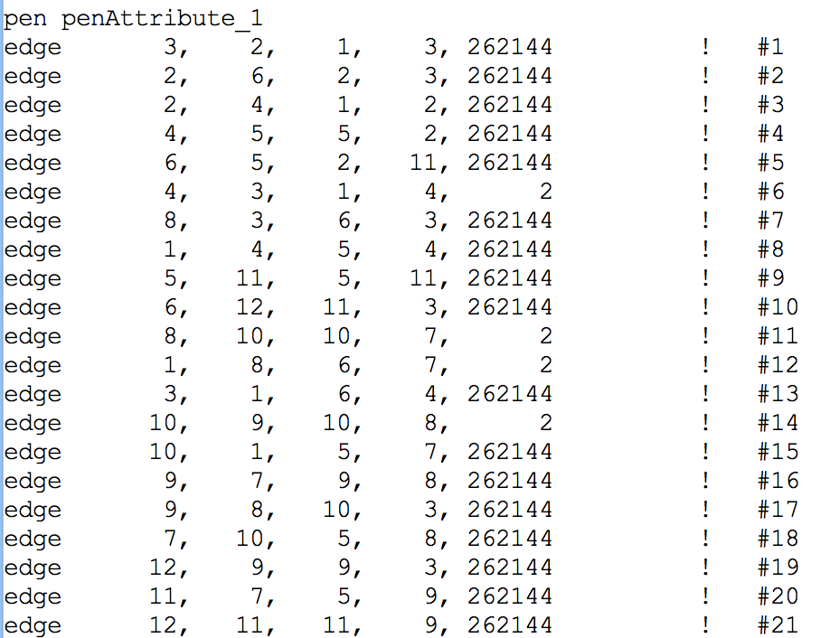

Some one know about other status code like 262144 for EDGE and their meaning?
It seem to be the 19th bit
1,2,4,8,16,32,64,128,
256,512,1024,2048,4096,8192,16384,32768,
65536,131072,262144

It showed in 17 IMHO - I am not sure, but it shows in some cases when edge in morph is hidden and saved in GDL.
It also prevents from downgrading the object to 16 and so on.
