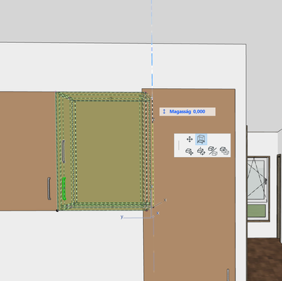

Hi!
Lately I have been having issues with  vertically stretching library parts using their hotspots in 3D view.  The operation causes the program to freeze up for about 20 seconds. This happens with library parts like chimneys and kitchen cabinets, so I'm guessing it has to do with complex, parameter driven geometries. Is this a known issue? Can we expect it being fixed soon?

Doubt it! Was reported a year ago and nothing has been done about it - https://community.graphisoft.com/t5/Modeling/Issues-with-modeling-in-3d-height-stretch-AC27/m-p/6361...

They have fixed it in the latest Update of AC 27:
https://graphisoft.com/downloads/archicad/updates/archicad-27-3-0#release-notes

Just tried with AC 28 with different libraries. The issue is still present. sorry for trusting their release notes. 🤔

Have just updated my AC27 to 27.3 Build 6000 and can confirm the issue still exists......😒
