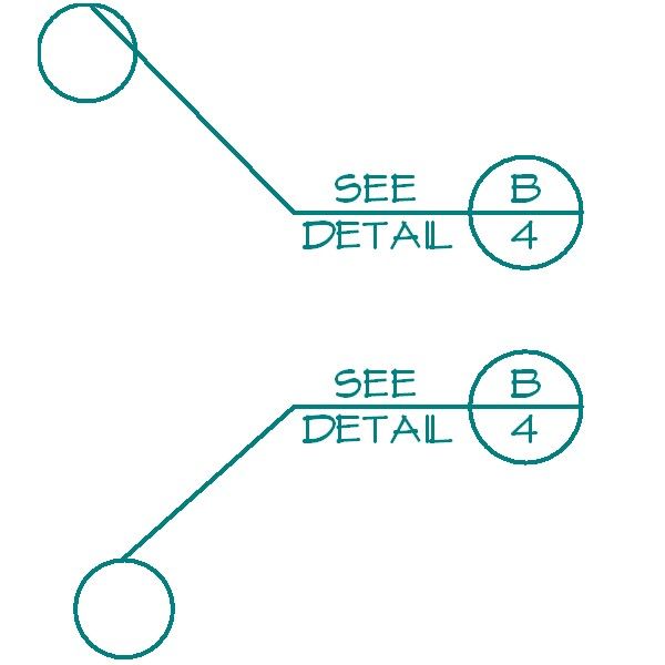

I created a detail callout that includes editable hotspots so that you can move the circle and have the line follow. Now the problem I'm running into is when I move the circle upward in the Y direction the line crosses through the circle. (See attached picture)
I understand the reason behind the line going through the circle. The line end is determined by the radius of the circle and is added in the Y direction. Can someone please tell me if there is away for the line to stay tangent to that circle no matter what the size the circle maybe.

Or is there away to have it act like the current line tool does.

I assume you mean perpendicular to the tangent, based on your picture.
You need to know the x, y of the circle center, and the x, y of the point where the line meets the horizontal line.
Let's call them cpX, cpY, epX, epY. (ep: end point)
You need to know the angle of that line. That's ng=ATN(rise/run) -> ng=ATN(ABS(cpY-epY)/ABS(cpX-epX)).
Once you know that angle, you can adjust the start point of the line:
(sp: start point, rds: radius)
spX=cpX+rds*COS(ng)
spY=cpY-rds*SIN(ng)
This is for the quadrant you show in your first picture. For the others, you'll need to change whether you add or subtract the rds*COS(ng) & rds*SIN(ng). You can find out what quadrant you're in by seeing which is greater of cpX/epX and cpY/epY. There's probably a better way, but my trig is not great and I can only find such things by trial and error. I build such things in +X, +Y first, then see what breaks when I go to other quadrants. The basic idea is right.
Then the line is LINE2 spX, spY, epX, epY, with a circle of CIRCLE2 cpX, cpY, rds.
HTH, (and hope I didn't make a mistake!)

Thanks that was very helpful. And yes you are correct I should have said perpendicular to the tangent.

Maybe it's simpler not to use the ABS inside the ATN.
The resulting angle from ATN function would be in range -90 to +90.
You then use the following code to convert it to the range -90 to 270 ('cvng' is the converted angle):
IF epX-cpX<0 THEN cvng=ng+180 ELSE cvng=ng
Notice that, for calculation of SINs and COSs, the range -90 to 270 is the same as the range 0 to 360 (e.g., SIN (-45) = SIN (315)).
This way, the script will 'know' the correct quadrant, by providing the proper negative or positive values for SINs and COSs.
But beware: you must provide a conditional calculation of 'ng' when epX=cpX, to avoid division by zero when calculating the ATN.
