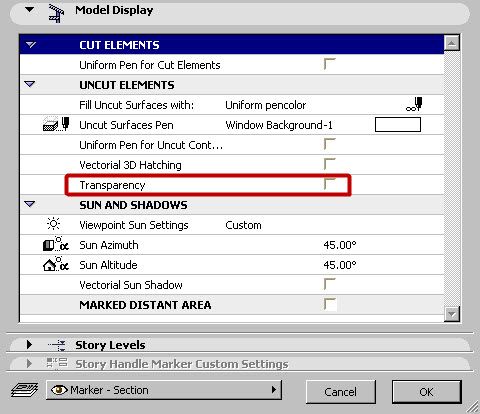

Can someone help me with turning off transparency in windows and doors while generating elevations. I know that I've been able to do it before.

In section / elevations' settings, uncheck "Transparency" in the <Model Display> tab (see the attached image).

view>3d view mode>3d window settings>Transparency in Shading.
Should do the trick!
It depends which version of AC you are using. Your signature says you have AC10 and AC9, both of which used the Transparency setting in the 3D window settings.
If you have upgraded to AC11 or 12 transparency is now turned on or off within the elevation tool itself.
