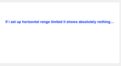

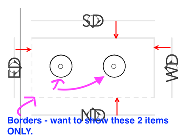

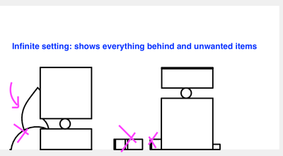

Working in interior elevations, I have set up border but the archicad ignores it and shows items behind elevations (unwanted).
Standardly, there is set up "infinite" which shows the elements and items behind and if I check "limited", it shows absolutely nothing - even if the item is within the border. What am I doing the border for ?
I have transparency off for this one and different setting and no change.
Edit: Adding wall helped .

I think you will find that you have placed the markers inside out.
The limit (you place first) is the extent to which you want to look.
You then place the markers inside that limit, for a view of the inside of a room.
The actual elevation lines can be moved if you need. to include the elements you want to see in the range.
It looks to me that you have set your markers on the outside of the limit and so you are looking in towards the limit, so the items are beyond your limit.
