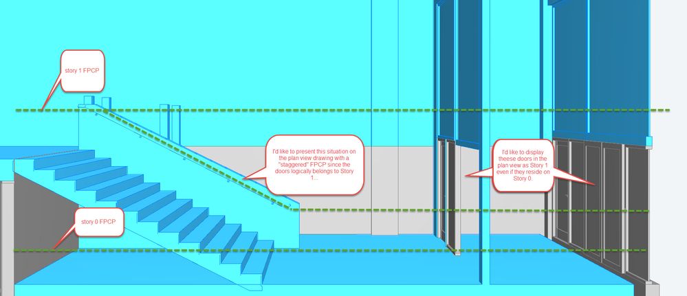

Best bet for "staggered" floor plan cut plane?
Mats Knutsson
Hi. Ages since I did this and what I remember I have to create two floor plan views with different floor plan cut planes. Any other bet? Story 0 is a garage while the entrance model wise is at story 0 but belongs to story 1 IRL.

Ricardo Lopez
Hi @Mats Knutsson
Watch this short YouTube video: https://youtu.be/s-UX_OfUdlA?si=iXPCert5EmJdgOAP
It is in Spanish but you can turn on Englsh subtitles if needed.
Basically you can play with copies of the same view with different range view settings applied and paste them in the layout.
I hope it works for you.
Best regards.
M. Arch. Ricardo López

This is how I usually do it. It was many years ago though and I guess the method is still valid.
