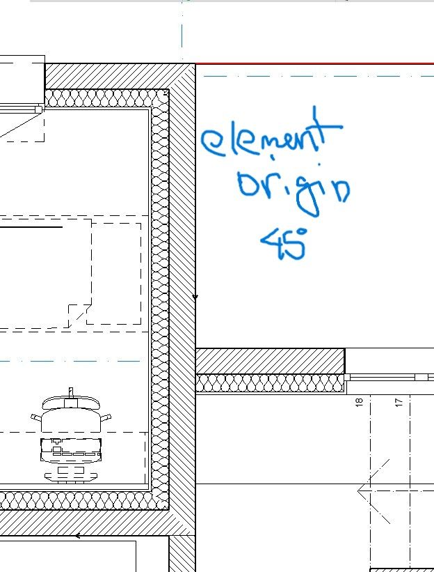

To fix that, I changed the material fill orientation from Project Origin to Element Origin, so the 45° fill looks correct in both plan and section.
However, this caused another issue: two identical walls now show opposite hatch directions in plan view.
I tried adjusting reference lines, wall direction, and composite settings, but nothing worked.
Please see the attached image.

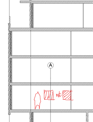

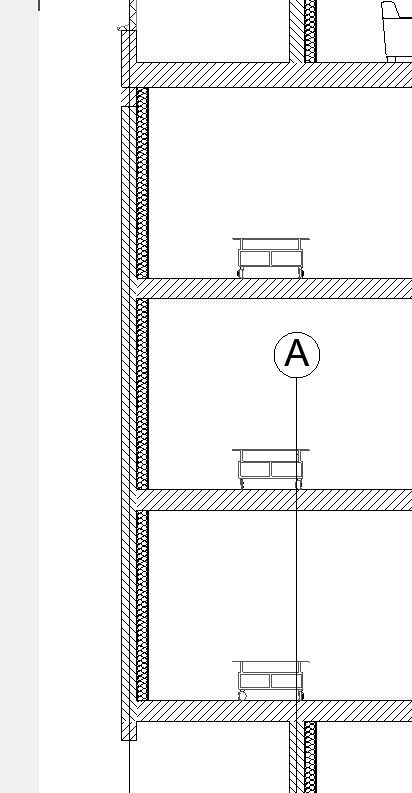

When I try Project origin option, It works on plan view, i can set perfect visually 45 degree hatch ( i had to insert around 81 degree to appear 45 degree hatch relatively to my project orientation ),
but when i make sections ( as long as "sections" don't use rotated workspace )
It became like shown on the image

After spending a full day trying to solve this issue, I found a workaround. I'm not sure if it's the correct method, but it worked for me.
I created two diagonal fills with different angles:
  • Fill A is for plans with rotated views. (In my case, I set it to 81° so it would appear as 45° in my rotated plan view.)
  • Fill B is for sections. (Set it directly to 45° if that's what you want.)
Then I created two Graphic Override Rules:
  1. One rule for all plan drawings.
  2. One rule for all section views.
    • Criteria: Element Type = elements u want to apply ( in my case = structure walls, slabs, beams ), and Building Material contains the material you want.
    • Under "Override Fill Type," I applied Fill B.
Finally, in the View Map, I applied the appropriate graphic override to each view—Fill A for plans and Fill B for sections.
All done in Project Origin, on Building materials section
