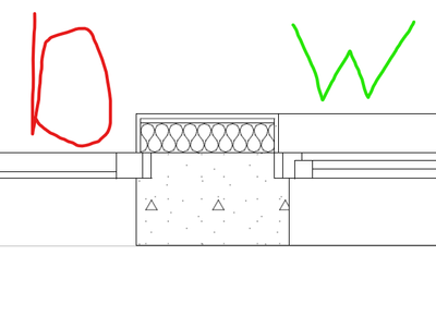

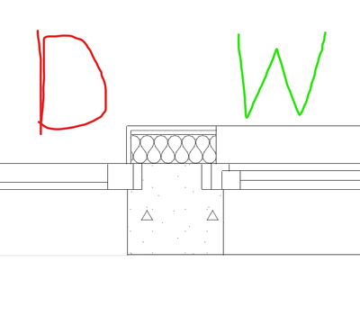

In Composites I created wall type with concrete outside, then insulation and finally double Gypsum Plaster inside as a finish. When I insert Door Tool finishing touches to door, but if I insert Window Tool finishing does not touch to window. Why? What is the difference between them?

I found setting named wall closure; I choose Plaster Reveal inside this option and pressed OK. Now it is shown as it should be.
