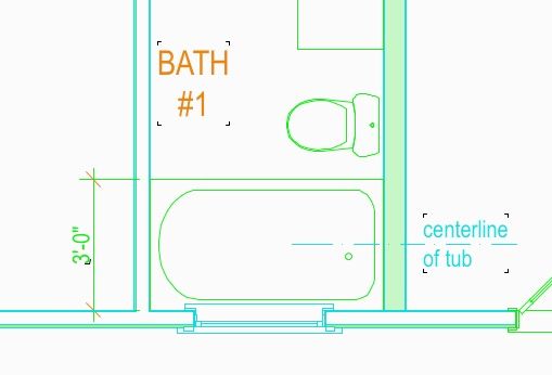

This library part works fine if you leave it at the default 2'-6" width. Make it wider or narrower, and the drain (in the 2D symbol) moves off center.
Am I missing a checkbox or something? I think the code is screwy and the drain always gets placed 1'-3" over from the side.

known bug.

the word causing it is MEP 😉
The positiong and of course autopositiong of the drain is in the part of the script that is activated when the MEP addon is installed.
I made a quick and dirty change in the sink object some time ago for my brother fighting it, he had reported it with detailed info...long time ago...
Probably the same way the bathtub could be fixed (but it must be done carefully so the MEP should also work with it)
