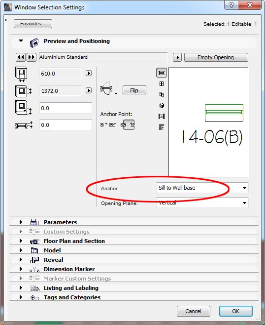

I am trying to find out if there is a REQUEST for GDL to allow me to query what the current window object 'Anchor' setting is - eg Sill to Wall Base / Head to Wall Base etc.
I have tried the GDL references and new features but cant find anything - I am hoping I have just missed it somewhere.

Not that I am aware of.
This is an anchor point for an object instance and can be controlled when placing the object but not through the script.
You do have the global variables of "WIDO_SILL_HEIGHT" and "WIDO_HEAD_HEIGHT" that might give you the control you want.
Thanks - I found a workaround.
