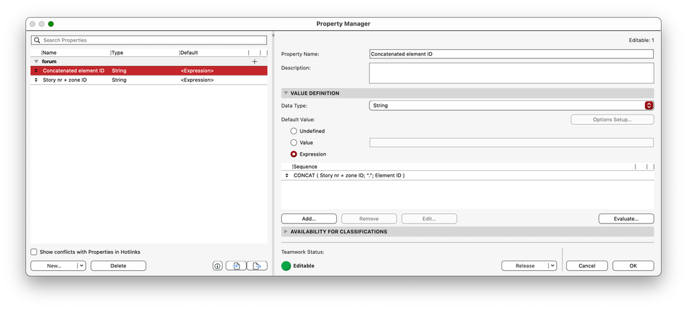

You can create an expression-based property and make it available to that class which is assigned to the door:
Technically what you write requires two properties, it's up to you whether you need to schedule 1B-02 somewhere or if you only need it for this purpose:

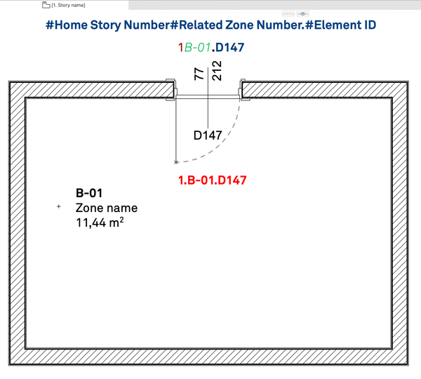

It should read as the red label in the screenshot. If you want to play with different formatting for the readability, you need to add each part to a label and save it as a favourite (I think rich text formatting is only supported in AC28 for label favourites).

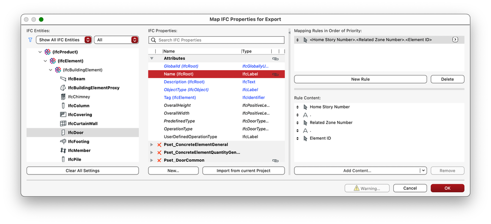

You could also export the concatenated property to the name, or you can use the IFC property mapping feature to push the concatenated ID to the Name of the object instead of the plain element ID (Create a "New Rule" the "Add Content..."):
