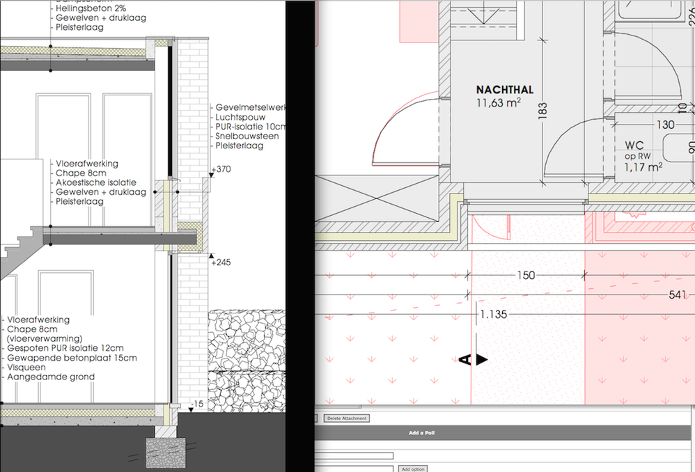

When I cut through my plan all my windows and doors are black where there used to be a white fill with a line in the middle.
On the plans there is no problem.
Is there somebody who knows where I can change this what I suppose to be a setting?
Thx!

Most obvious guess would be that the pen assigned to that fill has been changed, or the whole penset has been changed. Is that possible?
Cheers,
Link.
I did not touch the penset.
And I've tried tot change all pen that are black (see attachment) into white but there was no difference...
I think it's strange that the cut fill in my plan is good and not in the other view...
Erwin Edel
Rockstar
You only cut through the glass, the black fill is the cover fill (vectorial hatching) of the surface material of the window frame. You've applied surface material RAL 9005 to it, check the vectorial hatch settings of that material.
www.leloup.nl
ArchiCAD 9-26NED FULL
Windows 10 Pro
Adobe Design Premium CS5
Okay!
That was quit obvious Thx for your help!
