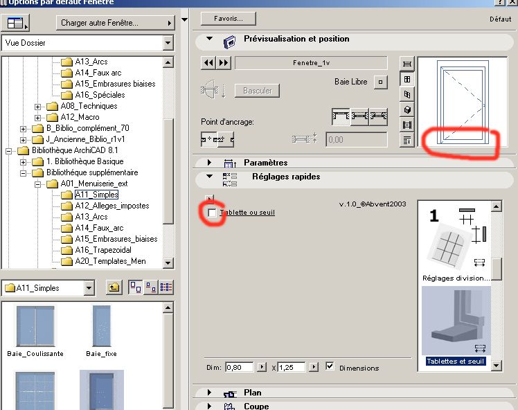

I noticed that whenever I draw a window with no sill (inside of a building) and I choose "no sill" in the settings window, the frame appears only on 3 sides and disappears horizontally.
This is weird for the sill is generally made of concrete and the window of wood, so two different things.
If you know how to deal with it, thanx in advance.

This is a bug or a feature of the particular window. In other words, it is a result of either a choice or an oversight of the person who wrote the code.
This probably needs to be altered in the GDL code itself to work as you wish.
