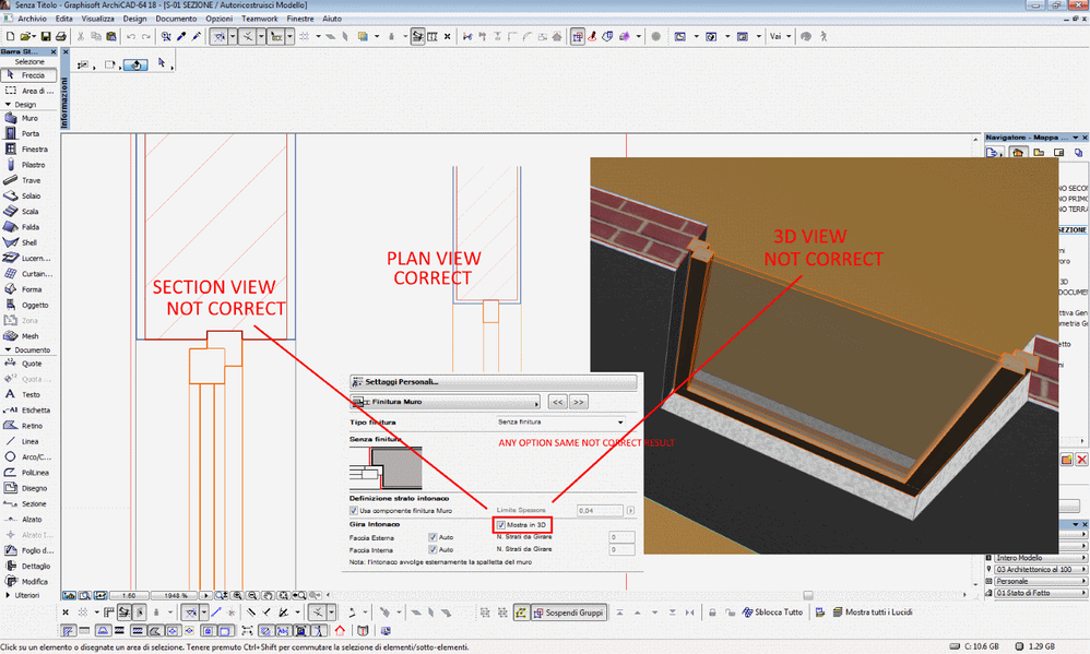

Look at the picture below.
It seems that the "show in 3D" option does not produce the expected result.
Is it a bug?
I remember this has been discussed in the forum some time before but I could not find the topic. Sorry.

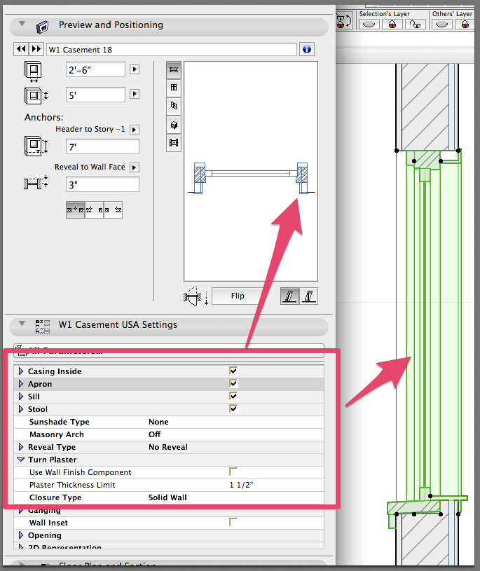

First finish going through all your window settings including sills, casings, frames, reveals and also the turn plaster (finish skins).
Also check your Detail Level settings for, 2D Detail Level, 3D Detail Level, and Show Reveal on Symbol found on the General Settings Tab. These can also be preset per MVO (model view setting).
These steps should get you closer to what you want. If not, Please elaborate and give an example of what you are after.
