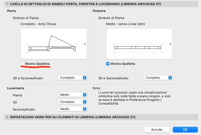

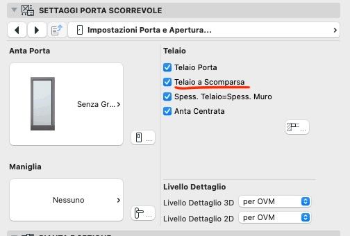

I am reporting a problem with Pocket Door 27. I am using the localized Italian version of Archicad.

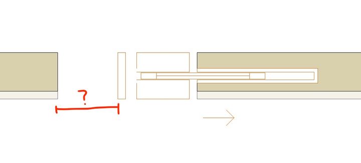

When I use a Pocket door with the option for displaying the hidden frame enabled (as in the attached image) and when the option for displaying the door leaf is disabled in the Model View Options, the door symbol seems to be displayed incorrectly, with the door leaf detached from the wall hole.
Is this a bug?
Thank you for your help.
Alessandro

Looks like a bug, but the place to report is the technical support in Italy.   The localized libraries are not merely language translations, but are often uniquely developed for each market.   For user support here, probably only someone else with the Italian version can verify the issue.

Same problem encountered here on the UK version. I use pocket sliding door all the time and have never seen this before. Seems to affect one file only, suggesting that file might be corrupted somehow.
Jon Pyle
Just to add, I can copy a wall with pocket door from another project (working correctly) into this file and it corrupts as above screenshot. I can then copy it back into the other file and it shows correctly there.
Tried restoring an old .bpn file from this project to see if the issue occurred recently but same problem exists. Short of attempting to copy the whole model into a new file (basically a whole day lost) I expect we'll just have to live with this and draw over if we really want to show the frame.
