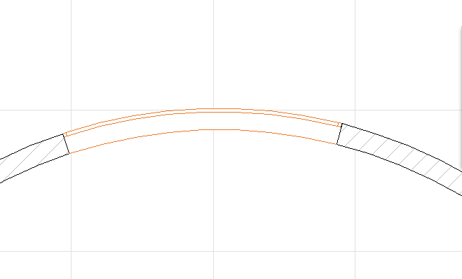

I've tried to make curved window, with curved glass, there is a selection in the tool settings, but nothing happens... is this a bug or am I doing something wrong?
may be this ?
mmm?
