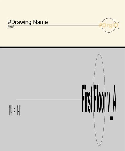

drawing title error

any help would be appreciated. see attachment for more info.
thanks

I had a similar problem a while back that was fixed by simply selecting "no title" and ok-ing, then return to settings and select your title again. It seemed to reset to the way it should be.
HTH

problem solved. thanks again!

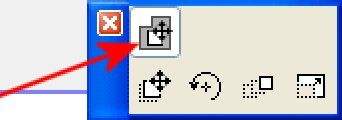

Drag the title and select the "move sub-element" option in the pet pallete.

I was able to get the sub element to respond a few times. But it was inconsistent in the different layouts. Usually it will only allow me to move the plan inside the drawings frame. The frame itself and the title in question stay in the same place.

You must pick on a node of the title to move it.
