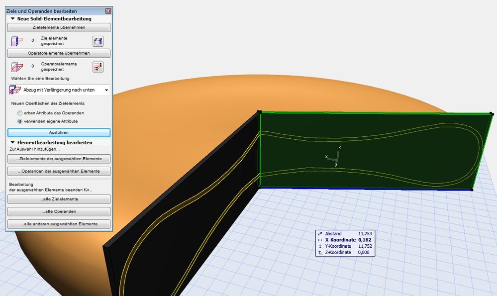

next step to creating the perfect cut chees rool in archicad.
how can i make walls at the open cut ends of my cheese roll.
i tried SOE but that just cuts the walls under the cheese or over the cheese but not in the cheese?
any ideas on my cheesy problem ?
Thanks.

ok i was able to use the original profile.
created a slab, then changed the 3d perspective to 90 degrees so i was looking from the real top down.
then saved it out as an object.
just brought it back into my main model file and with a little tweeking, i fitted it in.
