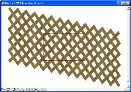

this has an alpha channel to knock out the voids. place it in the texturemap for the internal engine, size it - i guessed at 16" or so. Tell the alpha channel to be transparent and bump, then tell lightworks to match the internal engine.

you could use truss maker to create a latice. Of course this would mean using it for each section of fence.
Dwight
Absolutely brilliant and great for closeup. The trussmaker is versatile!
But you'd make the diagonals on lapped planes for shadow articulation.
One set of diagonals, then flipped for the cross pieces.
That shadow is important, as is controlling the opposing grain direction.
In my bitmap - a nasty little thing only good for distant views - the edges of the lattice pieces are lighter to simulate the change in plane.

I got this... diagonal lathe paneling.GSM... from objects on line years ago, and I use it constantly on drawings and renderings. All the ones on my site use it, but these small images w/ sketch settings don't show much.. but I think it's a great object. BTW, easy to link a property object to for take-offs.
http://www.thompsonplans.com/plans/pages/details/1414C but not much detail here at this web resolution and size, but you can get good detail.
I'll post a screen shot with AC's engine.

ps.. looks good in section details
