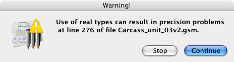

Hi- since upgrading I now get this error mesasge in a library part.
It refers to the line starting 11:
for i=1 to L step 1
11: if SO=i or SOO =i then 1000
if shelf3=i then 1000
if shelf=i then 1000
Anyone know what this means?
Cheers John
Hi John, you should look at this thread,
http://archicad-talk.graphisoft.com/viewtopic.php?t=4677&start=0
