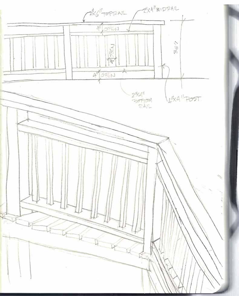

I'm looking for a railing tool that will make a railing for decks and stairs that looks like the one in these pictures. ArchiCAD has several railing ools but none that I've found can give me this particular railing for decks and stairs.
I'm open to third party tools too.
Mahalo,
John

Thank you for the heads up about the "Rail Post with Balusters" object. Unfortunately, in my version of ArchiCAD, United States v11, that railing object does not have the "Horizontal Rail Stile" or any way to add the two intermediate rails as showing in my sketch and photo.
This close but it doesn't quite do what I need it to do. I just spent hours creating the stairs and railings using the Slab, Column and Roof tools.
Thank you for your suggestion. I'm still looking for a tool or add in that will create the railing as shown above. It would be great if there was also a tool that created exterior decks as shown in the photo.

Personally, I model that kind of stuff out of slabs, beams, columns, etc. and hand build it. I find it less frustrating. And what you have pictured there is comprised of simple shapes so it would be very easy with a couple elevations and sections, and some 2D and 3D work.
