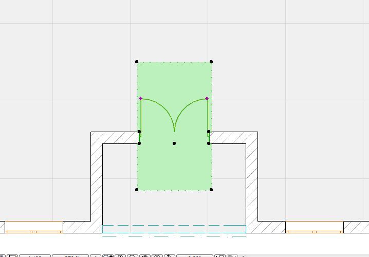

something strange during selection of door?
this highlighted green on the door is strange , i have nver seen it before it also leave its spot even if i deselect the door, so what is the matter?? please help me

Some doors have the option to show clearance/access requirements. You should be able to turn this off in the parameter settings.
is it the exact same name, please if you can guide me under what parameter(or category) i should find it? for example: under door sizes,or.. because i can not find it .
thanks
Sorry. I don't know the particulars. I almost never use the standard doors and even if I did I'm guessing the US parts are different from what you have in Egypt.

ahmed_hassan wrote:
/........ please help me
You need to look at Model View Options.
