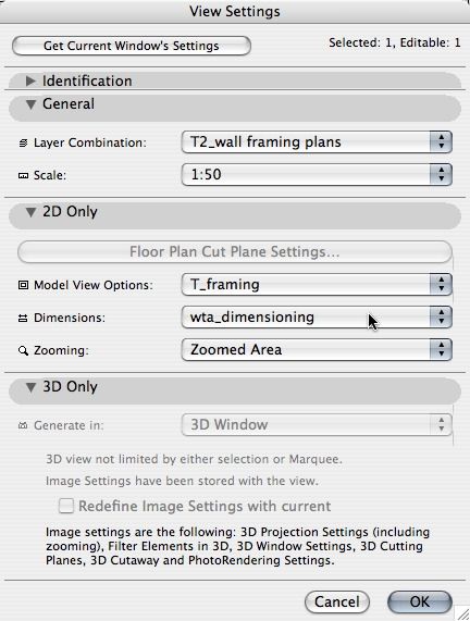

here's my latest stumbling block >> created new dimension standard via PREFS / DIMENSIONS that sets dims to 1/2" min rounding. each time i set it for the floor planit is OK until i leave the plan and come back; then it has reset to 1/16"?
__archiben
saved dimension 'standards' are saved with your VIEW . . . along with scale, layer combination, model view options, etc.
the nasty thing about saved views is that by default only the bare minimum of information about them is displayed at the bottom of the navigator . . .
look out for other things such as transparency (yes, the '3D window settings...' also affect section/elevation transparency! ), filtered 3D elements and cutting planes coming back to haunt you if they inadvertently get saved with a view. your dimension standards will stick if you are navigating through the project using the project map, but for them to take effect in saved views you will need to modify your view settings...
