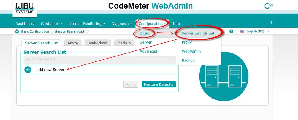

Thank you for your replies! So if we have network licenses, the VPN connection is enough? I don't need to take any USB (codemeter drivers or something) with me?
So long as Archicad is already on your laptop and is working then the codemeter drivers are installed.
All you need to do then is VPN into your office network to access the licenses.
That should be it as it should find the license automatically.
But you may need to add the server IP address to the Codemeter Control Centre if it doesn't.
Make sure you check your VPN connection and try to connect to a license before you go anywhere.
