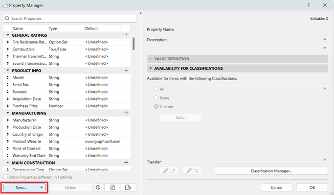

Open Property Manager
  • Navigate to Options > Property Manager to access the central hub for creating and managing custom project data.
  • You can also open this dialog directly from the Classification Manager. 
Create the Property
  • Click the New button at the bottom of the dialog box.
  • In the pop-up window, select the radio button for a new Property, give it a unique name, and assign it to an existing group.
  • Click OK to generate the property.

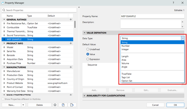

Choose a Data Type
  • Select your new property from the list on the left and set its Data Type in the right-hand panel.
  • This dictates the format of the information you want to capture, such as a String (for text), Number, True/False, or an Option Set (for a drop-down list of choices).

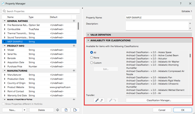

Set Classification Availability
  • Finally, configure the property's Availability for Classifications.
  • A custom property will only appear in the settings of an element or Building Material if its classification aligns with the availability rules you define here.

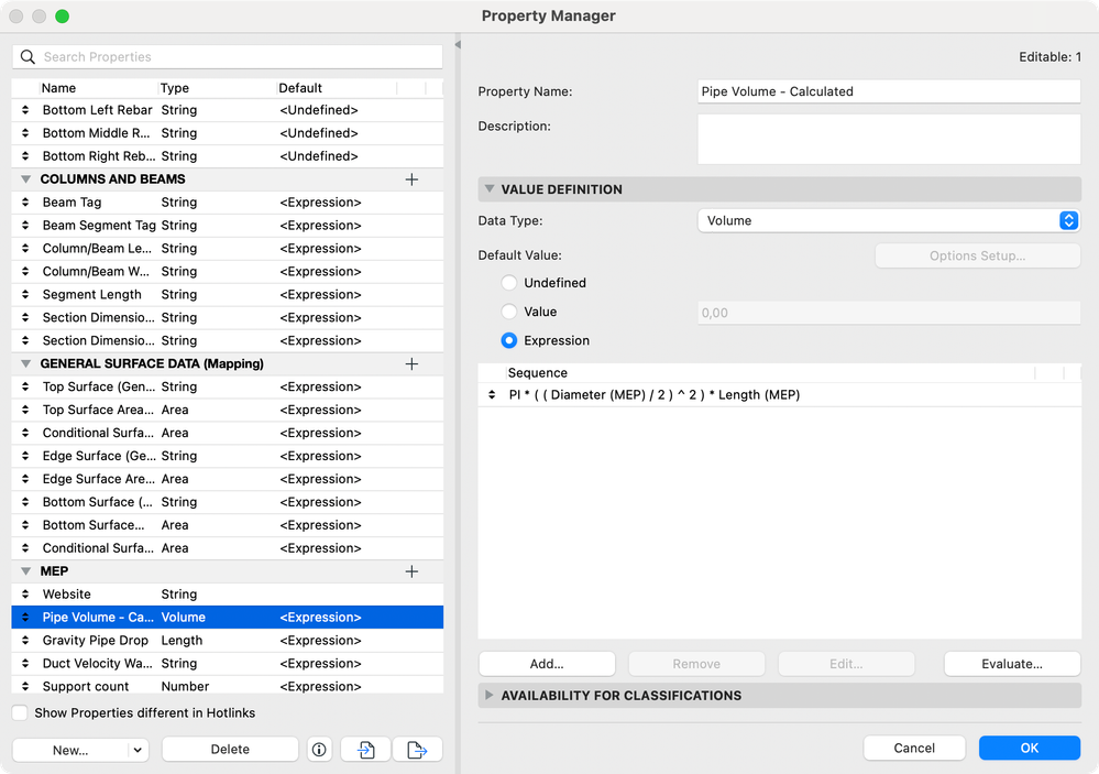

Create a New Expression-Defined Property: Step By Step
Functions in Expressions
Practical examples

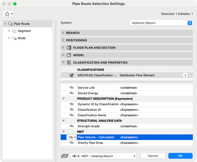

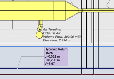

Pipe Volume (for take-offs)
Calculates the internal water capacity of a pipe.
  • Data Type: Volume
  • Formula: PI * ( (Diameter (MEP) / 2 ) ^ 2 ) * MEP/Length (MEP) 

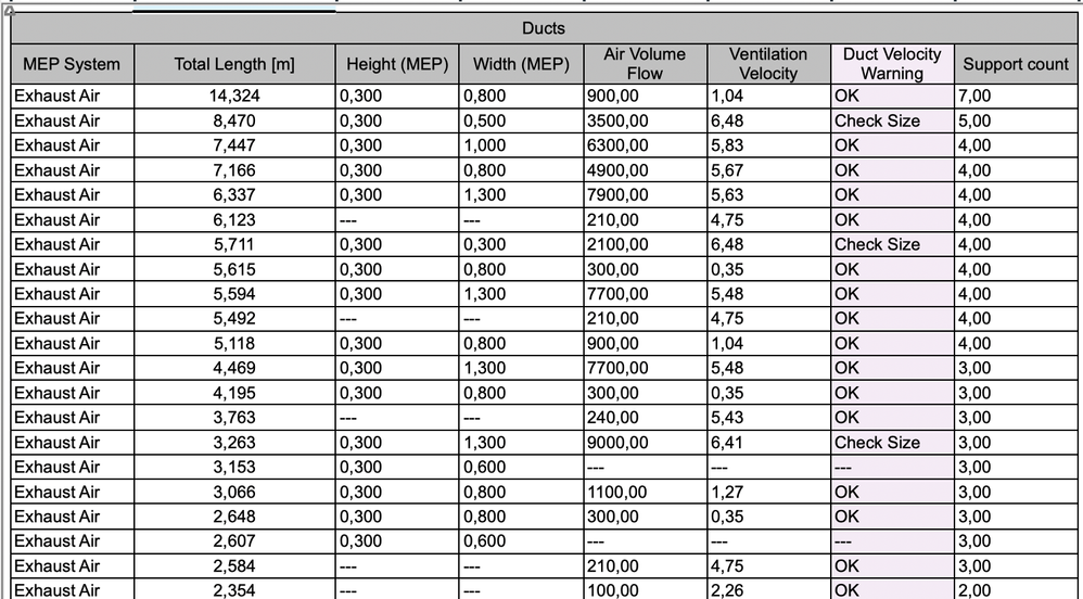

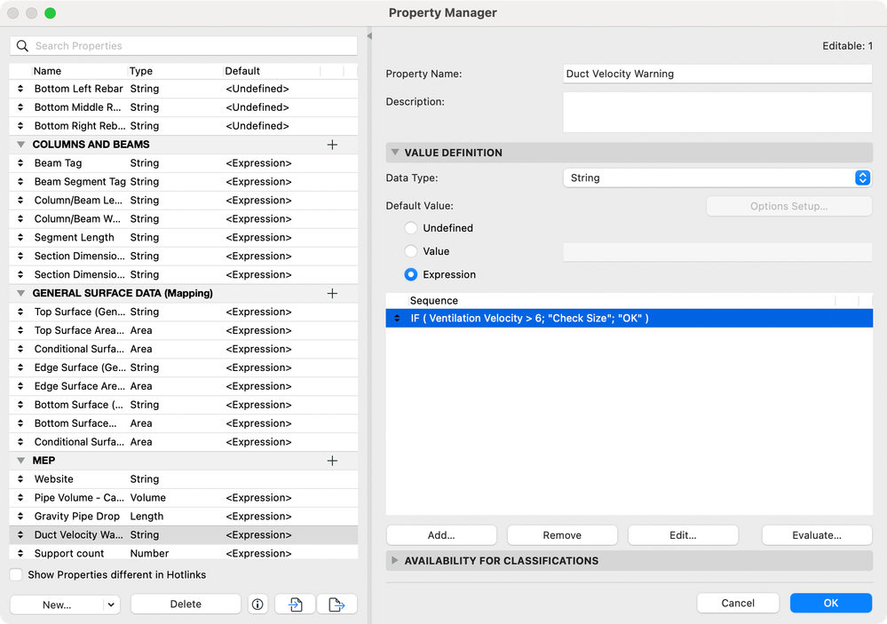

Velocity warning
Ventilation velocity is already part of MEP calculation data, and an expression can turn it into a schedule-friendly QA result. Check every rigid duct segment, if the ventilation velocity is bigger than 6 m/s.
  • Data Type: String
  • Formula: IF (Ventilation Velocity > 6; "Check Size"; "OK" )
