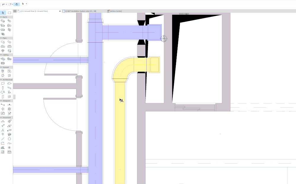

Edit individual segments and nodes - using Edit Mode
Use Edit Mode to select any single segment or node of a Route element and edit its parameters without affecting other routes. This is ideal for adjusting transition order, local dimensions, or other route-level settings with high precision.
Enter Edit Mode
  • Select a Route element.
  • Click the Edit button that appears on the selected Route
Using Edit Mode
  • Click any sub-element (node or segment) of the selected Route.
  • The regular toolbox is replaced by selection tools and a display palette, focusing your edits on the Route only.
  • From the Info Box, you can open a limited Settings dialog that applies only to the selected segment or node (for example to change parameters such as size or transition order).
  • Use the Environment toggle in the display palette to show or hide the rest of the model; in Edit Mode, you can only edit the sub-elements of the selected Route, not other elements.
  • The full Route Settings dialog is available from the display palette if you need to adjust broader Route-level settings.
  • Example: select a node and edit its Transition order to control how transitions are arranged along a route.

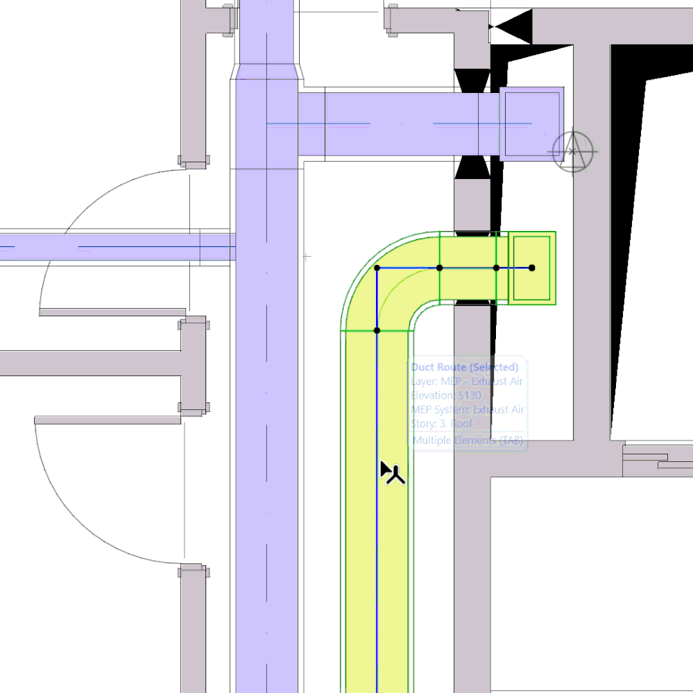

Edit segment diameter - with the Pet Palette
For quick changes to segment geometry, you can work without Edit Mode, using the Pet Palette on route segments. To change a segment’s diameter or dimensions (duct, pipe, or cable tray):
  • Select the route.
  • Click the reference line of the segment you want to edit (make sure MEP Reference Lines are turned on in 2D at View > On-Screen View Options).
  • From the Pet Palette, choose Edit Segment Dimensions.
  • In the dialog, edit:
    • The segment shape (for ducts),
    • The Table of Dimensions, and
    • The segment dimensions (e.g. diameter, width/height).
  • Click OK to update the segment in the model.
  • The available dimension values come from the selected Table of Dimensions, which is defined in Options > Project Preferences > Route Specifications.
