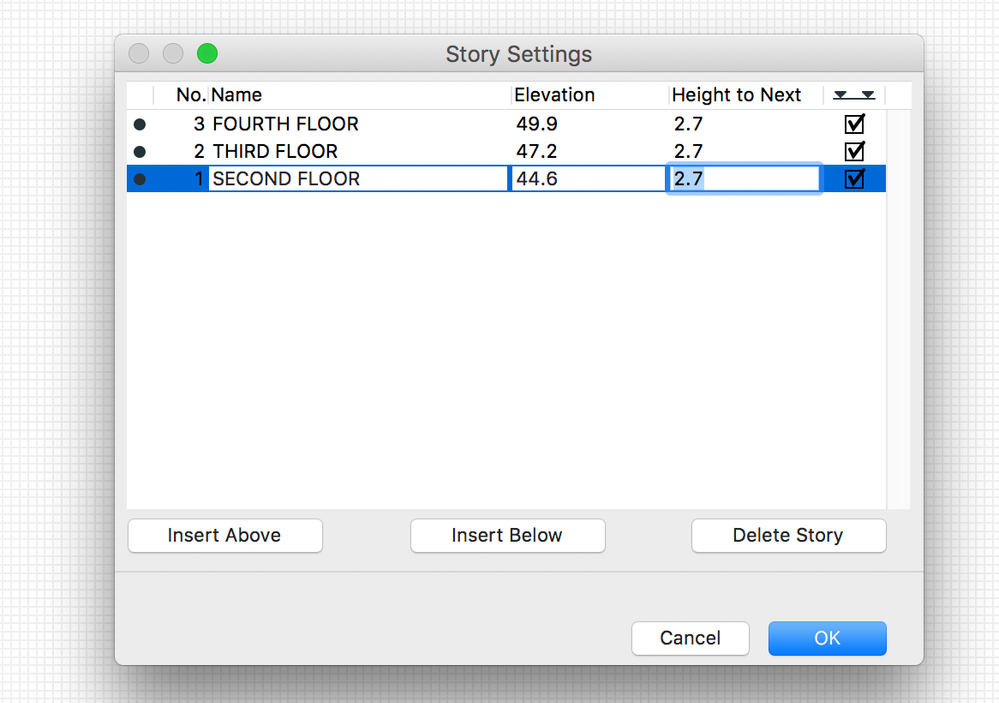

I set up values to 2 decimal places in the ARCHICAD/PROJECT PREFERENCES; but look like it is not showing up in the elevation levels. I want to set up the Height to Next as 2.65. Looks like it has round it off to 2.7.

It is the 'Working Units' that you are adjusting?
Seems to be working fine for me if I change decimal precision there.
