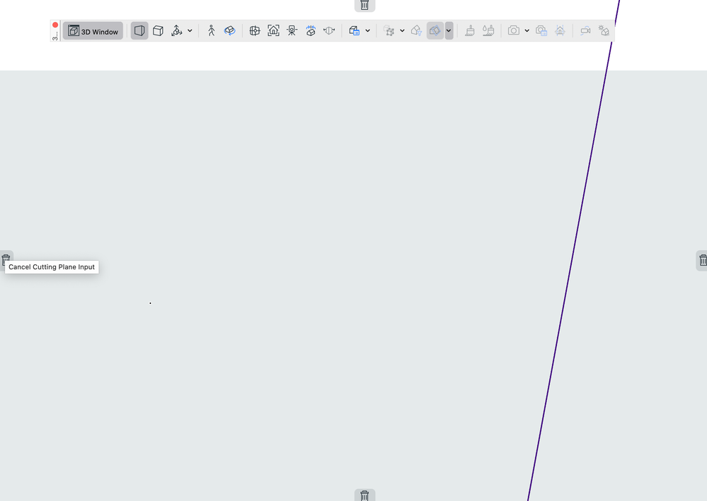

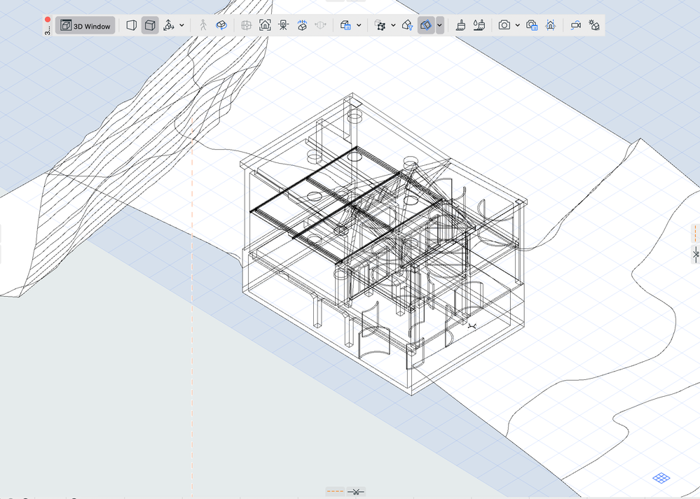

Hello everybody,
I have a huge problem. My 3D model isn't showing anymore. It started when I tried to align 3D objects in perspective view. After this, the cutting planes I was using, glitched and I couldn't see my model anymore. I thought it was just that, a glitch and tried to change the view. It persisted. It happened every time I used the cutting planes. If I select the individual objects and isolate them, they are seen. As soon as I select show everything, the whole model glitches out and it disappears, even though cutting planes are turned off.  If I go to the other views where it is cut, the model is fine until I select the cutting plane and it becomes wireframe even though it is set to a white model. I know it has something to do with the cutting planes, but I am at a loss about how it can be solved.  I would really appreciate it if someone could help me.

All of your screenshots show the Cutting Plane active?

Its me again. It was a problem with a few objects that were reaaaally far away. So using marquee tool and selecting everything that was outside solved the problem.
