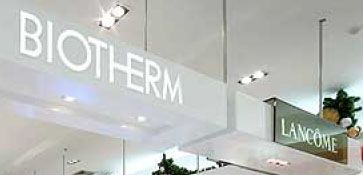

Can Archicad create "corporate logo" that can be incorporated into the 3D visual instead of using Artlantis to paste? See example attached.

Of course! Simply "Slabify" and "Save Model as 3d Object"
SLABIFY = Draw elements with slabs (or any other tool) as if it were laying flat on the ground
Show element in the 3d Window and from the FILE menu | Libraries and Objects | Save 3d Model as....
Choosing the correct orientation in the 3d window will mean that your "Sign" can STAND UP without having to do any scripting later. For a typical sign laying flat on the ground, choose ELEVATION view at 270degrees.

A simple way to make 3D sign elements is to use the complex profile as a wall instead of slabification. Place a short wall segment perpendicular to the base surface.

Hi vfrontiers....that's exactly what I did, trace the outline and slab it, save as object.
But is there a better & easy way especially when the logo gets more complicated. As it is with the above method, it's very time consuming.
