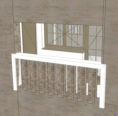

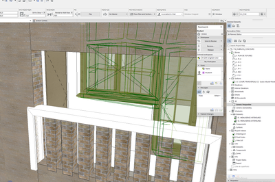

Hello everyone,
I am working with Archicad 28, and I’ve encountered a significant bug in my project file. The surface textures display incorrectly on large areas, and whenever I try to select an element in 3D, its vector outline is completely distorted (see attached image).
The file has also become noticeably slower and occasionally freezes, even during very basic operations.

cuba
Check if your project is far away from the archicad origin. The geometry gets dissorted when it is to far wary.

Matador264
I would like to point out that I do not have this issue with my other project files. The problem persists even if I open the file on another computer or when I copy the elements into a new file.
